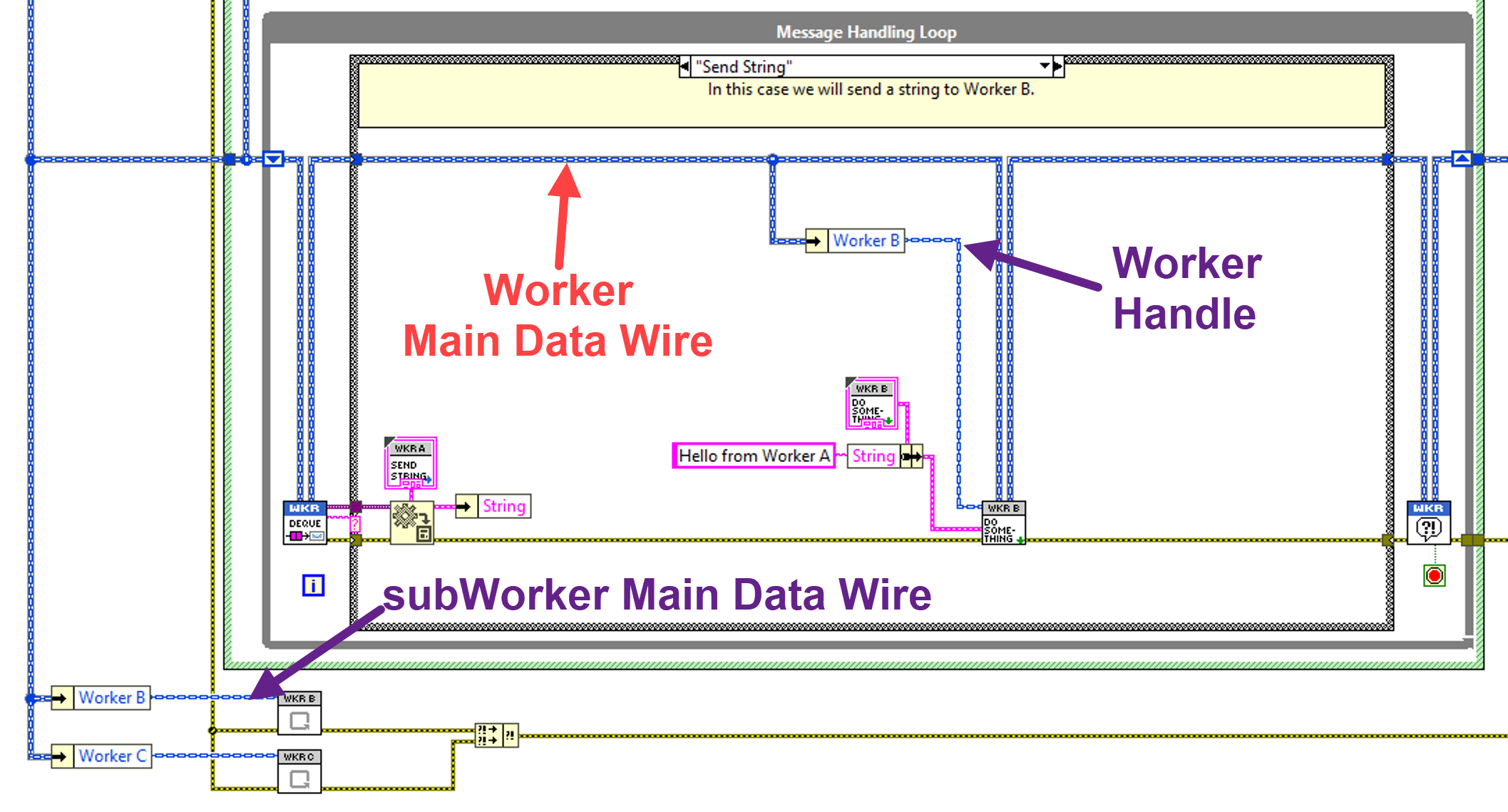

## Worker Main Data Wire
A Worker's Main Data Wire is the Worker class wire that starts at the Worker's object constant and runs through the Worker's MHL. See the image below.
<figure><img src="https://2767648102-files.gitbook.io/~/files/v0/b/gitbook-x-prod.appspot.com/o/spaces%2FZWihGdeYUalj239OUdAB%2Fuploads%2FgBLyqZI7ZSE7pVANZu1c%2Fimage.png?alt=media&amp;token=62b0c7db-4e06-4477-a676-d788dd7ebf80" alt=""><figcaption><p>Worker Main Data Wires and Worker Handles</p></figcaption></figure>
## Worker Handles
Worker handles are class wires that contain a Worker's Public Properties (such as the Worker's Message Queue). Worker handles are used to send messages to a specific Worker instance via the Worker's Public Request VIs. An example of a Worker's handle could be:
1. subWorker class wires that are used by a Caller's MHL (such as in the image above).
2. The Worker class wire that exits an [Asynchronous Launcher VI](https://docs.workersforlabview.io/fundamental-concepts/launcher-vis.md#asynchronous-launcher-vis).
3. The Worker class wire that exits a [Dynamically Load Worker Public API VI](https://docs.workersforlabview.io/workers-tools/workers-tools-menu/public-api-builder.md#create-dynamically-load-worker-vi).
