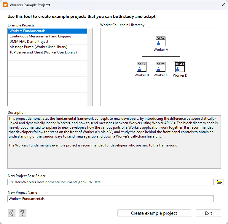

Five Workers examples projects are provided to help demonstrate the various ways to use the Workers API VIs, how Workers can be both statically-linked or dynamically loaded, and how to create an abstracted Worker API that can be used to create HALs. You can access the Workers Example Projects from the [Workers tools menu](https://docs.workersforlabview.io/workers-tools/workers-tools-menu.md).
<figure><img src="https://2767648102-files.gitbook.io/~/files/v0/b/gitbook-x-prod.appspot.com/o/spaces%2FZWihGdeYUalj239OUdAB%2Fuploads%2FhX5sJLnOfD1dtqlvvNqT%2Fimage.png?alt=media&amp;token=b2cc17de-712f-4944-9a25-aa52476767da" alt=""><figcaption><p>The Workers example projects</p></figcaption></figure>
