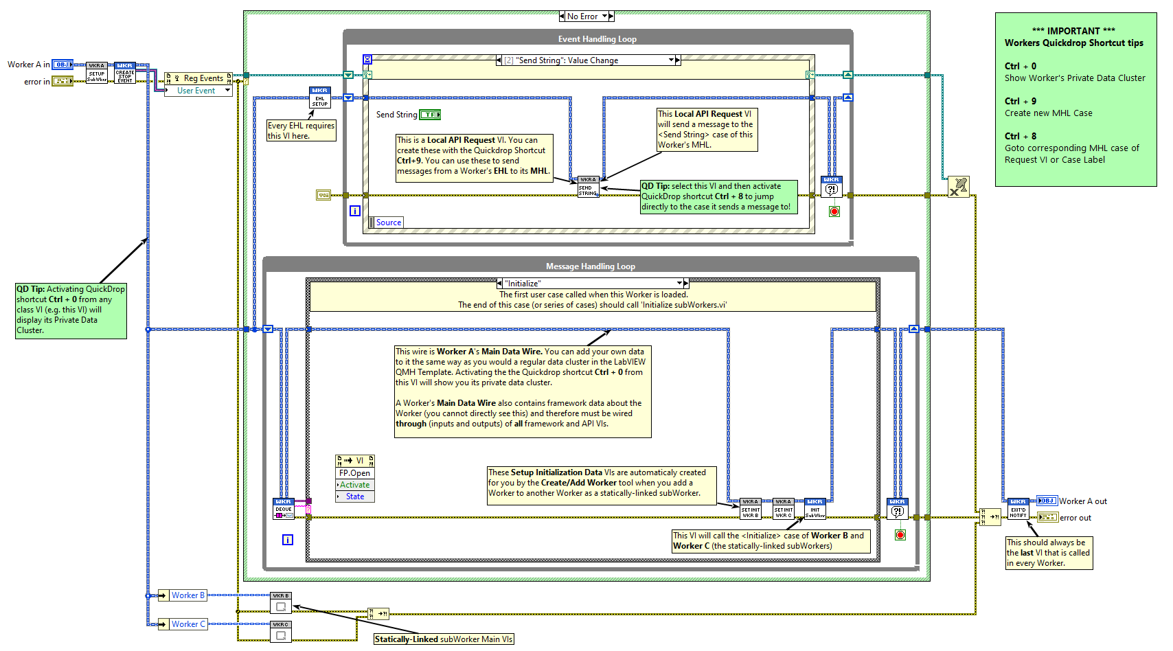

## Fundamentals Example Project
There are several example projects that ship with Workers 5.0. However, the best starting place for developers who are new to the framework is the Workers Fundamentals Example Project.
This example project demonstrates the fundamental framework concepts to new developers, by introducing the difference between statically-linked and dynamically loaded Workers, and how to send messages between Workers using Worker API VIs. The block diagram code is heavily documented to explain to new developers how the various parts of a Workers application work together.
It is recommended that developers follow the steps on the front of Worker A's Main VI, and study the code behind the front panel controls to obtain an understanding of the various ways to send messages up and down a Worker's call-chain hierarchy.
<figure><img src="https://2767648102-files.gitbook.io/~/files/v0/b/gitbook-x-prod.appspot.com/o/spaces%2FZWihGdeYUalj239OUdAB%2Fuploads%2F1jTPqgGo3rw6miDqOiZB%2Fimage.png?alt=media&amp;token=b32e6c70-8daf-4112-a87b-8382cf5ed8e6" alt=""><figcaption><p>Fundamentals Example Project - Worker A (Main.vi)</p></figcaption></figure>
Click here to learn more about the [Workers 5.0 Example Projects](https://docs.workersforlabview.io/getting-started/example-projects.md).
