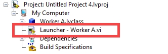

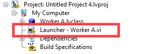

The following image shows a Launcher VI for a Worker in a LabVIEW project, and below that the block diagram of the Launcher VI.
![](https://content.gitbook.com/content/ZWihGdeYUalj239OUdAB/blobs/j8JIuv9haYAWG51GjqfI/Launcher%20VI%20in%20project.png)
![Launcher - Worker A.vi](https://2767648102-files.gitbook.io/~/files/v0/b/gitbook-x-prod.appspot.com/o/spaces%2FZWihGdeYUalj239OUdAB%2Fuploads%2FEr1XKfw0uTOSR7PzrdB5%2Fimage.png?alt=media\&token=fe7407ff-a6cf-4556-a118-f1ccd2a68099)
A Launcher VI contains (from left to right):
* the class object constant of the application's head Worker
* the Worker's palette VI: *Debug Client Loader.vi*
* the Worker's palette VI: *Setup Head Worker.vi*
* the Main VI (Main.vi) of the application's head Worker.
