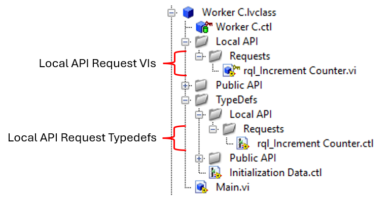

**Step 2 :** In your LabVIEW project, remove from your Worker the associated Request VI and typedef for the Local Request called "**Increment Counter**". These are shown in the diagram below.
<figure><img src="https://2767648102-files.gitbook.io/~/files/v0/b/gitbook-x-prod.appspot.com/o/spaces%2FZWihGdeYUalj239OUdAB%2Fuploads%2FXRgxLSrzkEv0qkjzetyV%2Fimage.png?alt=media&amp;token=c0601c83-be90-427e-9473-bb8275b9bbd8" alt="" width="563"><figcaption><p>Items to delete in project for a Local Request called "Increment Counter"</p></figcaption></figure>
**Step 3 :** Remove all instances where the Local Request VI (and typedef) were used throughout your application.
**Step 4 :** Finally, delete the Local Request VI and typedef from where they are saved on disk.

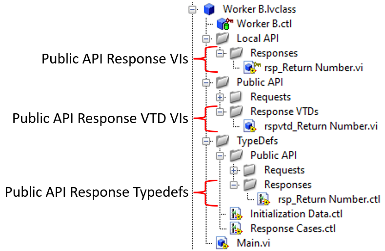

**Step 1 :** In your LabVIEW project, remove from your Worker the associated Response VIs and typedef for the Public Response called "**Return Number**. These are shown in the diagram below.
<figure><img src="https://2767648102-files.gitbook.io/~/files/v0/b/gitbook-x-prod.appspot.com/o/spaces%2FZWihGdeYUalj239OUdAB%2Fuploads%2FjvHoaBBNM61wle3liGUr%2Fimage.png?alt=media&amp;token=07d76644-0fbd-4627-b53f-63beb85a9654" alt="" width="563"><figcaption><p>Items to delete in project for a Public Response called "Return Number"</p></figcaption></figure>
**Step 2 :** Remove all instances where the Public Response VIs (and typedef) were used throughout your application.
**Step 3 :** Finally, delete the Public Response VIs and typedef from where they are saved on disk.
**Step 4 :** From the Worker's *Response Cases.ctl*, you need to remove the string control that has the same label name as the Public Response. In this example, we want to remove the string control called "**Return Number**" from the cluster, as shown below.
