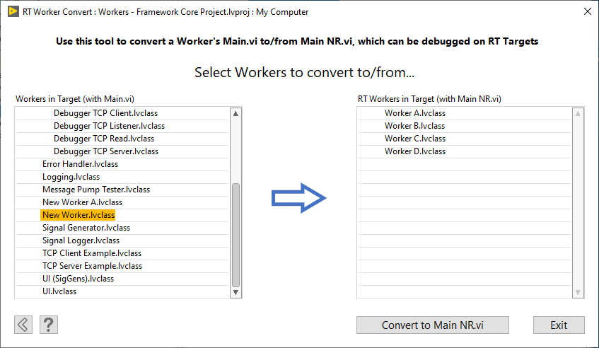

The RT Worker Convert tool allows you to convert a Worker's Main VI between its reentrant (Main.vi) and non-reentrant (Main NR.vi) forms.&#x20;
By default (for non-RT targets), a Worker's Main VI is reentrant, allowing you to load and run multiple instances of a Worker within the same application. However, for development on NI real-time (RT) targets such as a Compact RIO, it is often preferred to develop using non-reentrant Worker Main VIs (Main NR.vi) so that debugging of the Workers Main VI is possible in LabVIEW.
The RT Worker Convert tool allows you to convert a *Main.vi* to and from *Main NR.vi.*
![RT Worker Convert tool](https://content.gitbook.com/content/ZWihGdeYUalj239OUdAB/blobs/AaXzwGBKIeL9LClPi3Bd/RT%20Worker%20Convert%20tool.png)
When you open this tool, you will see the left list show Workers on your target with *Main.vi*'s. The right list will show Workers on your target with *Main NR.vi*'s.
Selecting one or more Workers in either list (mutually exclusive) and then pressing the **Convert to (Main VI)** button will replace the Worker's *Main.vi* with a *Main NR.vi* (or vice versa).
