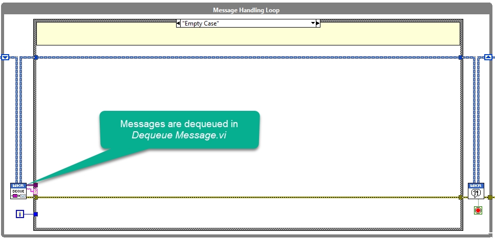

Each Worker is assigned a message queue by its Caller when the Worker is created. (Head Workers have their message queue assigned by the *Setup Head Worker.vi* in the Worker's Launcher VI.) Messages are dequeued by the *Dequeue Message.vi* at the beginning of a Worker's MHL.
![](https://content.gitbook.com/content/ZWihGdeYUalj239OUdAB/blobs/VfqqfB0T9VNby4O17bGt/Messages%20Dequeued.png)
