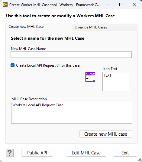

## Create MHL Case tool (new)
The QuickDrop shortcut **Ctrl+9** , when activated from the block diagram of a Worker's Main VI, will open this tool. This tool allows you to create: Local API Requests, MHL cases to receive Response messages from subWorkers, and undefined MHL cases that will be created with a Case Label. The tool can also be used to override non-Public API MHL cases from a Worker base class into a Worker.
You can learn more about the new Create MHL Case tool in the section: [Create MHL Case tool](/workers-tools/quickdrop-shortcuts/create-mhl-case-tool-ctrl+9.md).

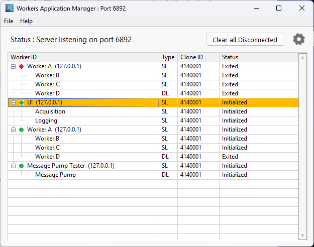

### Application Manager&#x20;
The new Debug Server launches into the Application Manager window, showing you a list of all Workers applications running on your local network. It is now possible to display multiple Workers applications that have the same Head Worker Alias and IP Address within the new [Application Manager](/workers-tools/workers-tools-menu/workers-debug-server/workers-application-manager.md).
<figure><img src="https://2767648102-files.gitbook.io/~/files/v0/b/gitbook-x-prod.appspot.com/o/spaces%2FZWihGdeYUalj239OUdAB%2Fuploads%2FPeggDEkZ1Z30wKGr7gRX%2Fimage.png?alt=media&amp;token=771fac95-8976-4a15-af88-d8a685537b38" alt=""><figcaption><p>Workers 5.0 Debug Server - Application Manager</p></figcaption></figure>

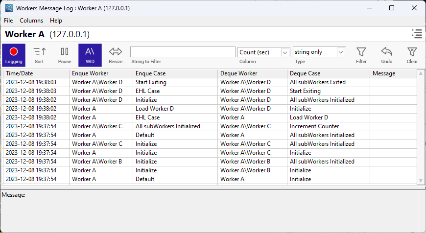

### Message Logs
It is now possible to display individual [Message Logs](/workers-tools/workers-tools-menu/workers-debug-server/worker-message-logs.md) for each Workers application that is connected to the Debug Server. Right-clicking over an application in the Application Manager's tree-list will provide you with this option. It is now possible to continuously log all received messages to file using the new Live Logging feature built into the new Message Logs.
<figure><img src="https://2767648102-files.gitbook.io/~/files/v0/b/gitbook-x-prod.appspot.com/o/spaces%2FZWihGdeYUalj239OUdAB%2Fuploads%2FrIpV24gFFvOVcC9wrjXV%2Fimage.png?alt=media&amp;token=cb98daf6-1720-45d1-a2b9-dffec829d959" alt=""><figcaption><p>Workers 5.0 Debug Server - Message Log</p></figcaption></figure>
You can learn more about the new Workers Debug Server in the section: [Workers Debug Server](/workers-tools/workers-tools-menu/workers-debug-server.md).

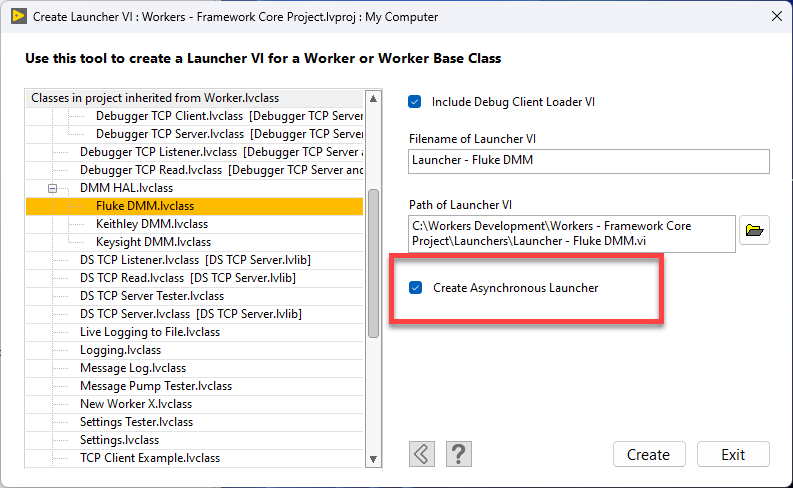

## Create Asynchronous Launcher (new feature)
The Create Launcher VI tool has been upgraded, and now allows you to create Asynchronous Launcher VIs for both Workers and Worker base classes. Asynchronous Launcher VIs allow you to load multiple instances of a Workers application, and provides the Worker class object as an output, allowing you to use a Worker's Public API Request VIs from external LabVIEW applications such as TestStand.
You can learn more about the new Create Launcher VI tool in the section: [Create Launcher VI](/workers-tools/workers-tools-menu/create-launcher-vi.md) tool.

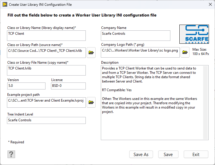

## Worker User Library Configuration File Editor (new)
It is now possible to create and edit configuration files for the Worker User Library tool. This editor allows you to fill out all of the config file fields, making it now easier to add functional Workers to the Worker User Library.
You can learn more about the new Config File Editor tool in the section: [Config File Editor](/workers-tools/workers-tools-menu/worker-user-library/config-file-editor.md).
